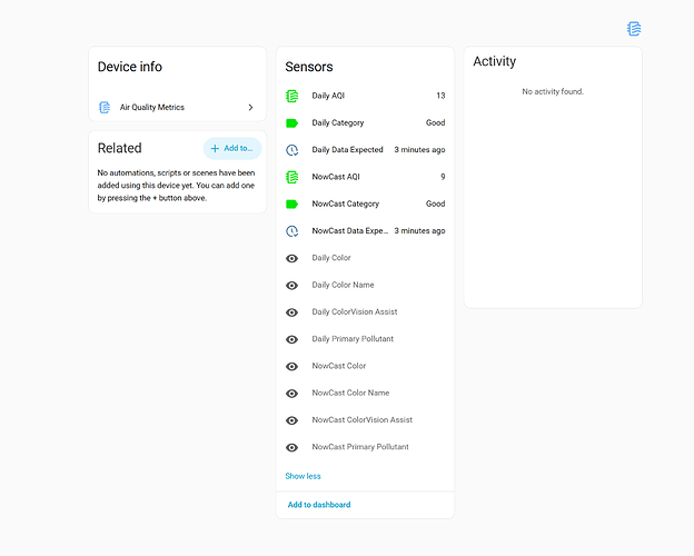

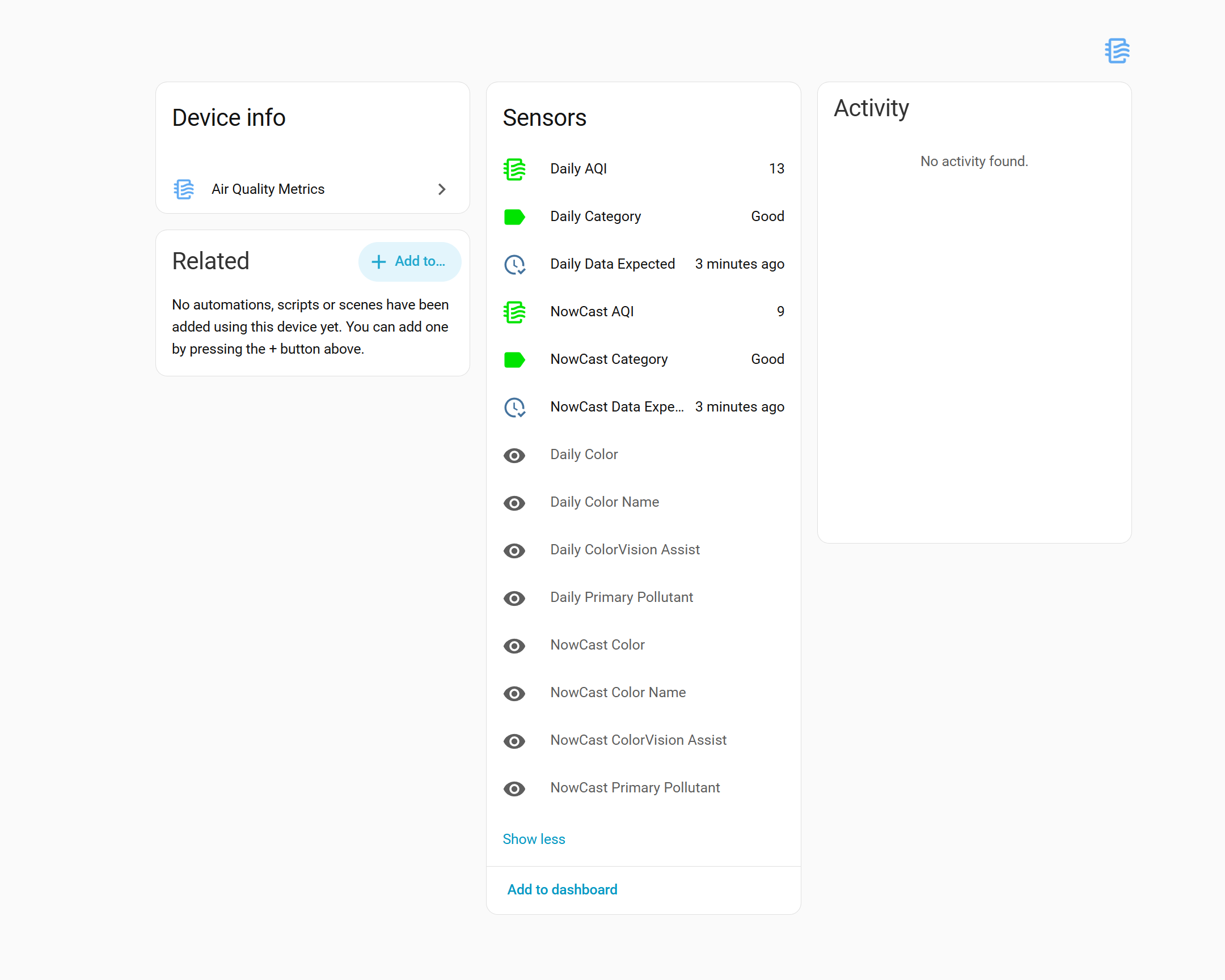

I’ve been talking about figuring out how to move these calculations into Home Assistant itself for years, so I finally worked up the motivation to do so over the last couple weeks. This also gave me a chance to look into indoor air quality metrics. This first release of the integration provides the following sensors, along with some additional info like official category names and color codes:
  • Indoor Sensors
    • IAQI: ATMO produced this scale and formula as a way to produce a rating
      similar to AQI, but for indoor spaces.
  • Outdoor Sensors
    • EPA NowCast AQI: This is what most people think of when they hear “AQI.”
    • EPA AQI: Intended as a general air quality score spread across an entire day.

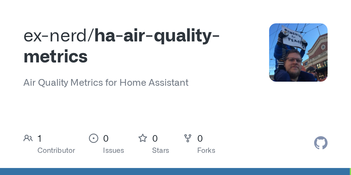

You can find all of the info about the plugin at github, including planned future work and a few items I’m looking for help with. Installation is currently via HACS as a custom repository:
In case you would prefer to follow updates there, I also cross-posted this to the Home Assistant community forum: Local Indoor and Outdoor Air Quality (AQI, NowCast, IAQI) - #2 by ex-nerd - Custom Integrations - Home Assistant Community

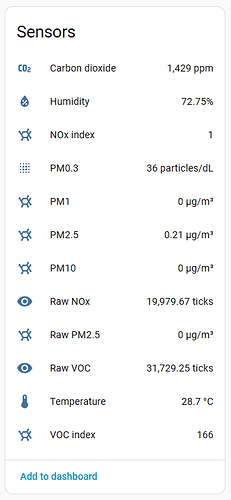

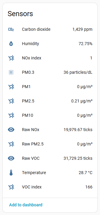

@ex-nerd anyway, I saw that you have a plan to support more sensors. Please let me know if I can help test it. The current AirGradient Open Air and ONE (for sure, I have both!) have these entities:
Hopefully, we’ll see the Open Air Max O-M-1PPSTON (with NO2 and O3 supports) compatible with Home Assistant sometime in the future.

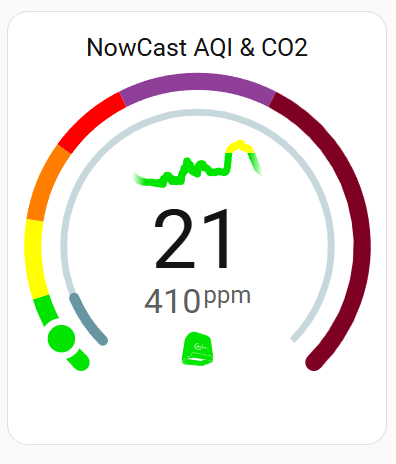

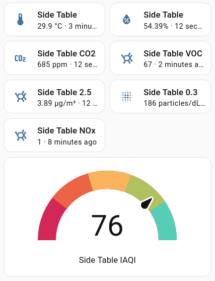

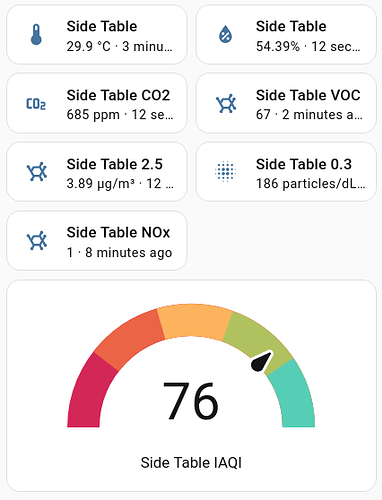

It was easy to set up with my AirGradient ONE and using your gauge example provides a nice visual indicator for the relevant raw sensors:
Recently, I’ve also found this custom gauge, which is incredibly helpful for viewing multi-pollutant: GitHub - selvalt7/modern-circular-gauge: Modern circular gauge card for Home Assistant · GitHub
Not only for air quality metrics though, but I also use it for almost everything I have on my HA dashboard, like my PC monitor, electrical voltage, current, etc.
