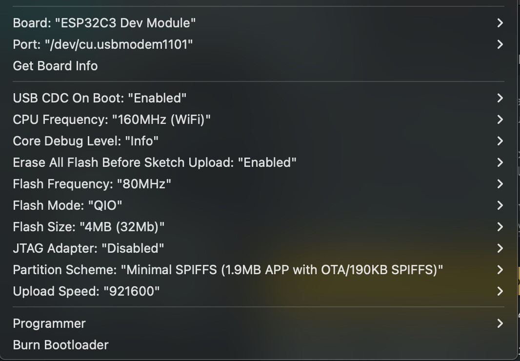

I am running into a persistent boot loop on my AirGradient ONE Indoor (v9) when trying to upload code via the Arduino IDE. While the official Web Flasher works perfectly and the device runs fine with it, any manual compilation from the IDE results in a blank screen and a serial loop showing rst:0x3 (RTC_SW_SYS_RST) every ~300ms. I have already downgraded my ESP32 Board Manager to v2.0.17, tried both QIO and DIO flash modes, and verified my board settings (ESP32C3 Dev Module with USB CDC Enabled) as instructed by the compilation guide on github arduino/docs/howto-compile.md at master · airgradienthq/arduino · GitHub. Since the hardware is clearly functional via the web flash, I figured something is wrong with the way I am attempting to update the firmware on my device. Any pointers or advice on how I can further debug here?

Arduino IDE config:
Sample of serial monitor logs after following compile instructions and uploading OneOpenAir.ino:

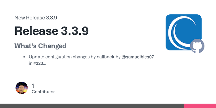

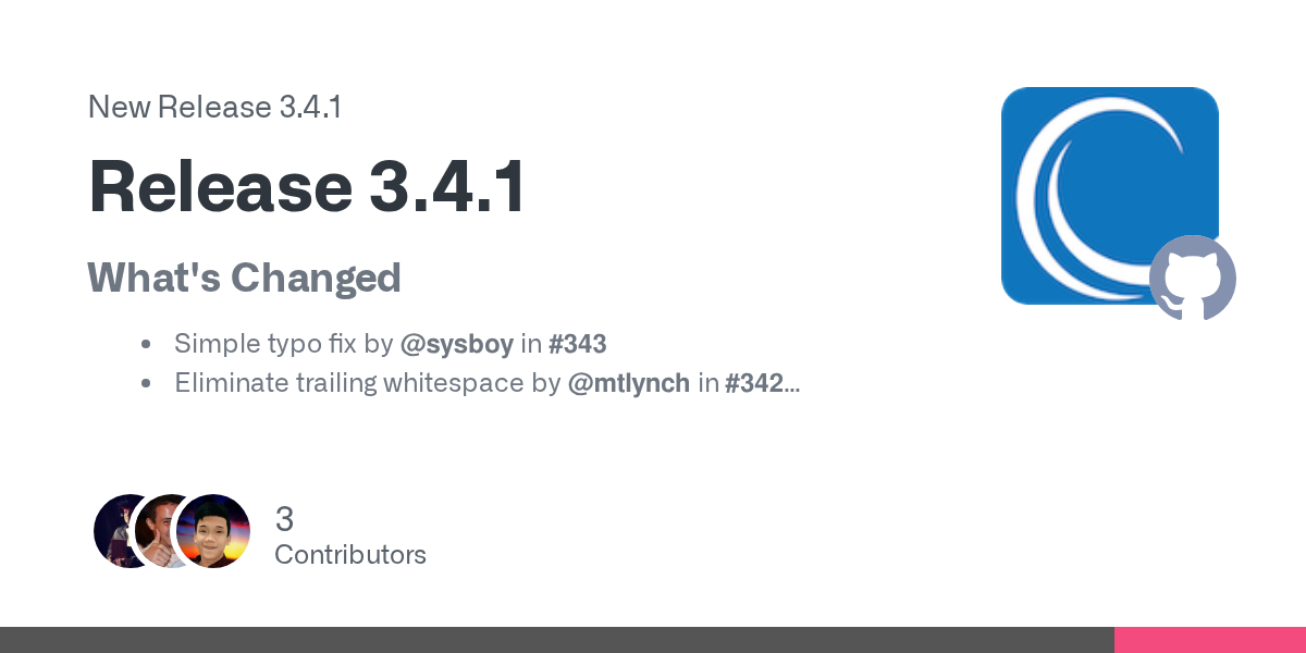

You might try going back to one of the official release versions that are listed on the Dashboard.
3.4.1 is the lasted release so I would try download the source code directly from that release
And follow the directions for syncing the submodules. See if that runs stable or go back one more release
