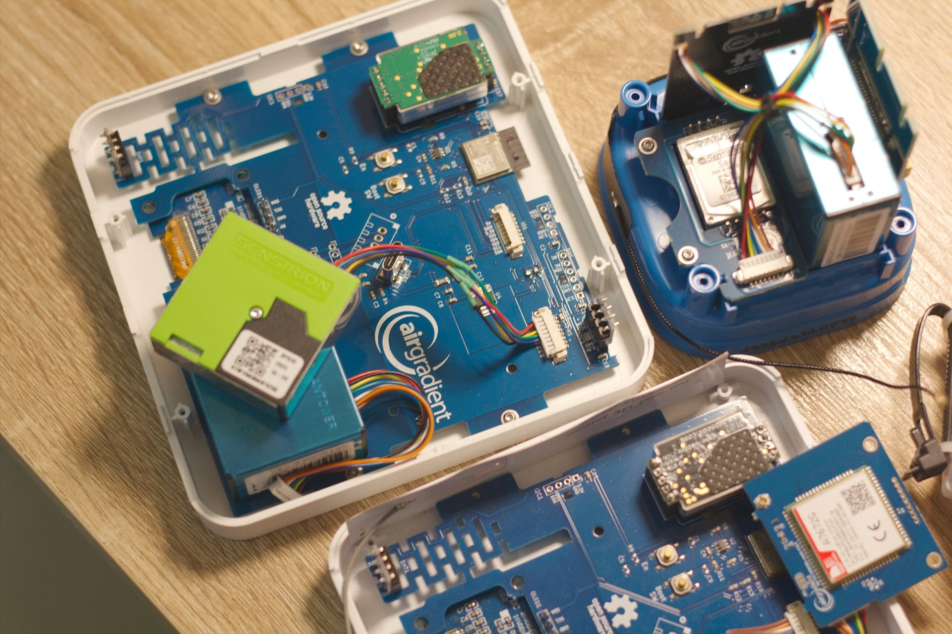

  • Added support for the Sensirion SPS30 PM sensor (for both ONE and Open Air)

We’ve been testing the Sensirion SPS30 more extensively and have become more familiar with it, especially since it is also used in the AirGradient Go.
Adding support in the ONE and Open Air firmware gives us more flexibility and lets us support it as an option alongside the Plantower sensors.
