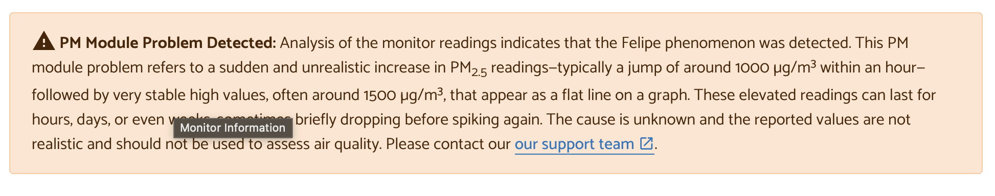

Generally, if there are issues there will be signs in the dashboard such as missing data. Also with PM sensors, we have added an automatic algorithm that detects possible fault and displays a warning in the dashboard:
