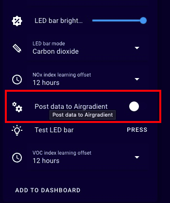

I just found this setting in H.A. It appears to turn off data to airgradient. Just testing it.
airgradient1

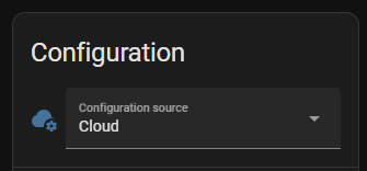

I see now. Many options only show up once you change to the Local configuration source. Since I had Cloud, I didn’t see them.
