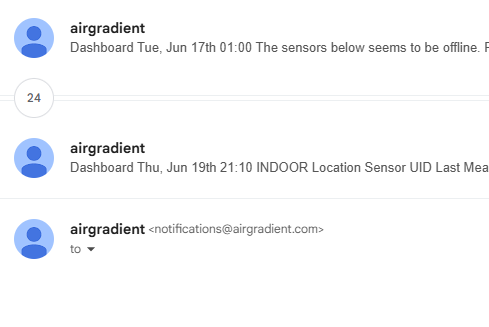

I set up a new AirGradient One indoors last week and connected it to the AirGradient dashboard. The monitor itself has been working great, but in two days I’ve gotten 27 email notifications telling me that it’s gone offline:

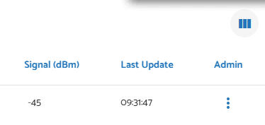

Thanks for the suggestion. It’s not a signal issue - the monitor is about 3 meters from the access point, and I am able to ping it without issues. The last time it was up, the signal was -38 dBm:

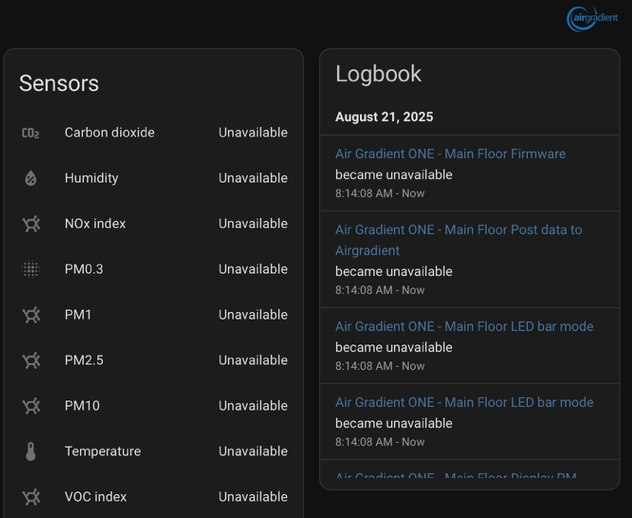

I’ve attached a screenshot of a typical intermittent dropout lasting about ~30s, multiple times per hour. I also used Gemini Pro to do deep research into this issue and it found what I also suspect is a “Update Fail Reboot Loop”, since I’m also seeing the Firmware Turn Off and Firmware Turn On activity sequence in the logs after these drop outs. Several corroborating screenshots were submitted to AG support last week. Ticket is open and active (I believe @Ethan_AirGradient is looking into this).

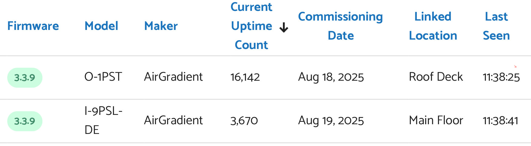

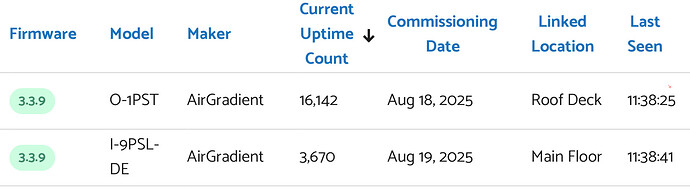

@MallocArray Here’s what I’m seeing in terms of uptime, with both devices setup one day apart.
The devices are not rebooting at all as far I I could tell. Pretty stable!
The AG One is in a prominent main floor location and when I look at my HA dashboard while a dropout occurs the device OLED display metrics are unaffected. I also check the AG dashboard. Also not affected when HA dropout occurs.
Note both the AG one and Open Air devices experience HA connectivity issues at different intervals separately.
Thanks again!
Yep, so doesn’t look to be the device rebooting, which is good.

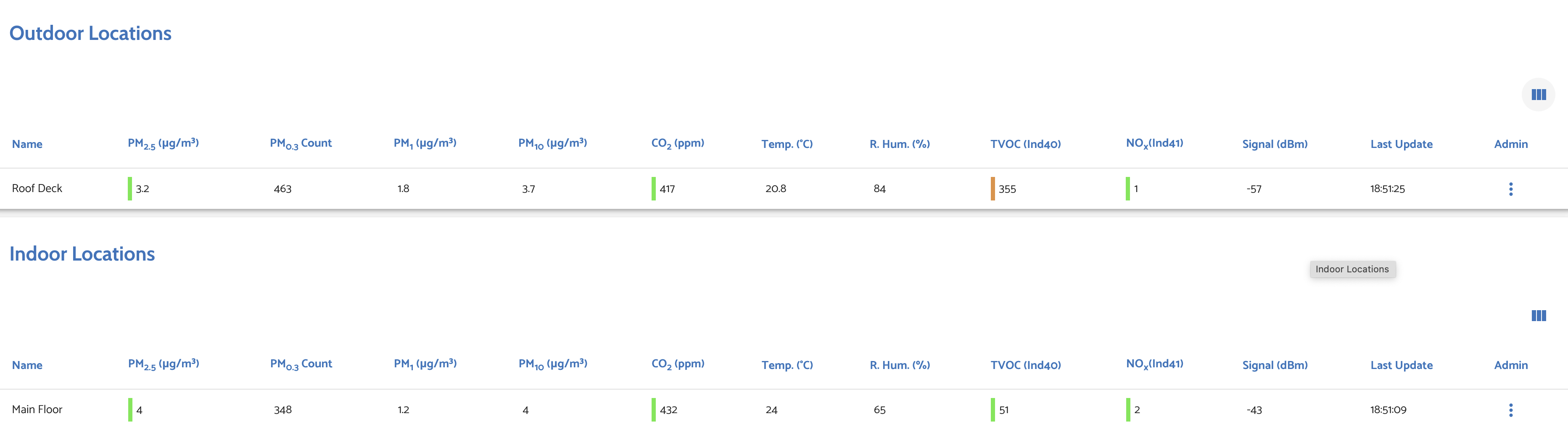

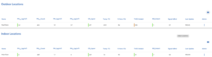

@MallocArray, here you go…
Signal on both devices are pretty solid! The network infrastructure is also on a pretty beastly setup with an Asus RT-AX89X and 3 hard wired Asus RT-AX86U AP’s (AP’s are running on a MoCa 2.0 network via Ethernet backhaul). Additionally, I have direct Fibre Optic to my home with symmetrical internet 1.5GB Up/Down.
