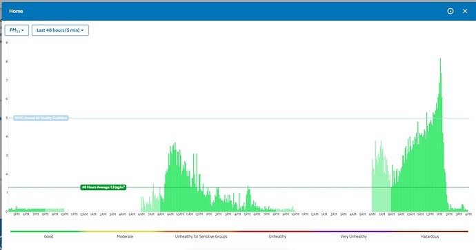

Just wanted to report that here where the air quality index is 170 “unhealthy”, I am seeing 0 PM 2.5 right now with a DIY cube fan with 1 inch filters running on low since 2 pm, and fresh air ventilation turned off. It does spike up when I open a door to the outside and comes back down over a few minutes. First time using it.

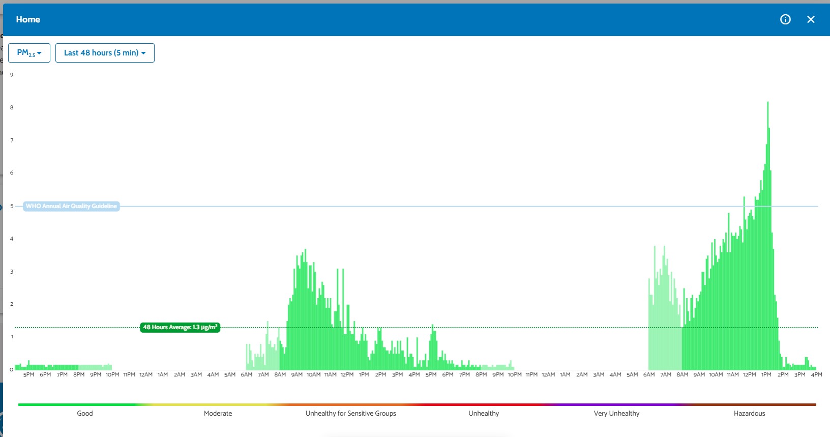

You see the sudden dropoff at about 2 pm, toward the right side of the graph, when I turned the fan on.

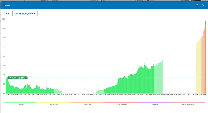

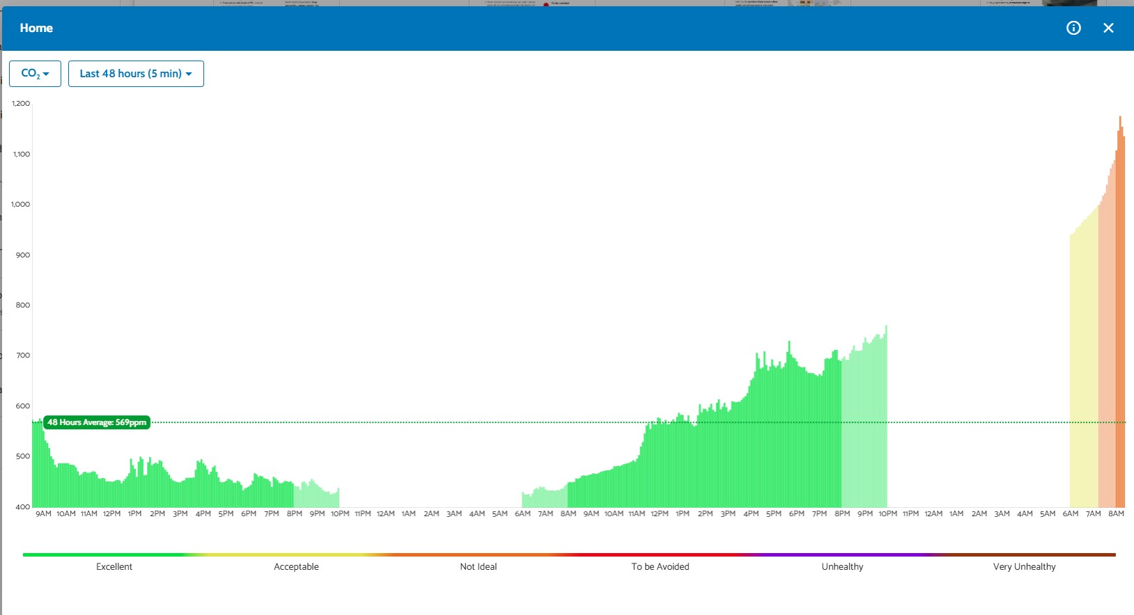

Just be aware, if your home is air sealed and you turn off fresh air ventilation, CO2 can rise to unacceptable levels. Mine rose to 1131 as of this morning, so I turned it back on - CO2 is dropping slowly while PM2.5 is creeping up. It’s going to be a balancing act.
That’s interesting. So when your fresh air ventilation is on (I assume that it is a whole-home ventilation system), PM2.5 creeps up because the indoor pressure is getting lower, and then the outdoor air can easily get inside? Or is there something else involved in this case?
This is positive pressure whole home ventilation, bringing outside air in. lowering CO2 but raising PM2.5 when there is wildfire smoke. Running ventilation is necessary in any air sealed home to keep CO2 from rising too high. The cube fan provides additional filtration to lower PM2.5.

BTW the gaps in the charts are when the wifi is turned off overnight.
We see 1100 to 1200 CO2 indoors most of the year (when windows are closed) . . . and don’t worry much. When it’s 5F outside, I’m darn well NOT opening a window!
