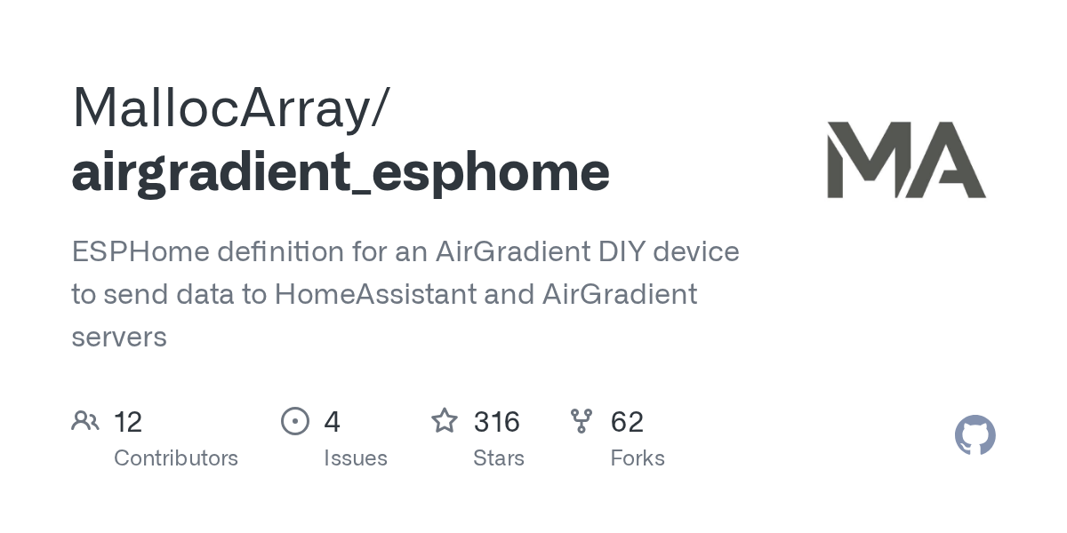

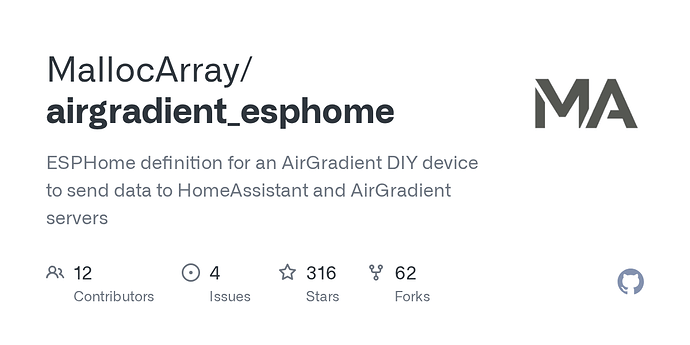

In the ESPHome alternative configuration there are additional options including the left 5 for CO2, the next 5 for PM2.5, and the final one for VOC, so it is laid out similar to the display.

There is an alternative ESP32 firmware?
You can check out this for the ESP configuration. It is a bit more to setup, but integrates nicely with Home Assistant and can do a ton of other things so you might find more uses for it around the house

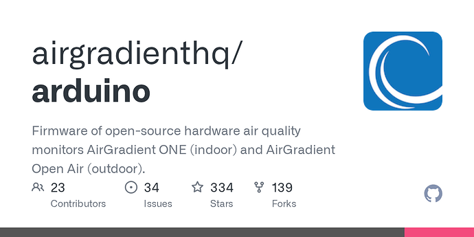

All of the official code is available on their Github site:
This is the mention of bringing more LED bar options to the main code, but just a public contributor, not one of the core team
