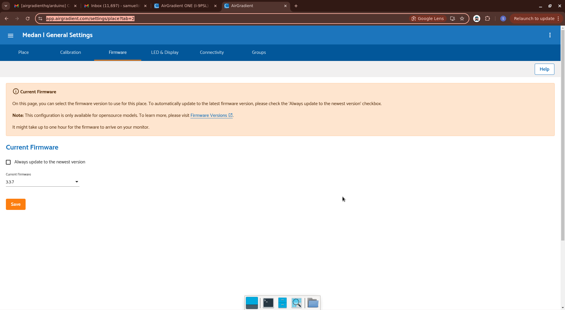

Hi @everyone,
Just like Achim said, we have a problem right now to add the new firmware on our website flasher. But latest automatic firmware update already available for 3.3.7. Make sure you set firmware version on our dashboard to 3.3.7

Edit: Reflashing this morning to 3.3.6 seems to have allowed it to update to 3.3.7 and fix the problems.

Try this link, goto domain /documentation/factory/
Working as expected, looks like the firmware page hasn’t been updated yet.
