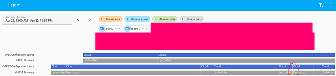

I have an indoor unit in one location and an outdoor unit in another location. Based on what I see in HA, they both got (successfully) updated this morning (UTC). I’ve attached a screenshot of how HA saw the process of the indoor unit. It looks very similar for the outdoor unit.
What’s weird is that I have another indoor unit in the same location with the outdoor unit and HA doesn’t show any change for it. So either this unit’s been on 3.3.6 for a longer time or somehow HA missed its update.

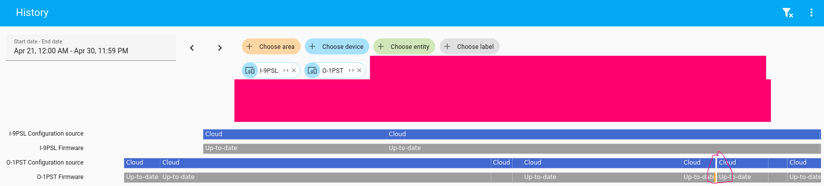

Also a screenshot from HomeAssistant with both the outdoor and indoor device. I’ve marked when the outdoor was updated in the lower right part.
Edit: forgot to mention, I see the same in the Dashboard.
