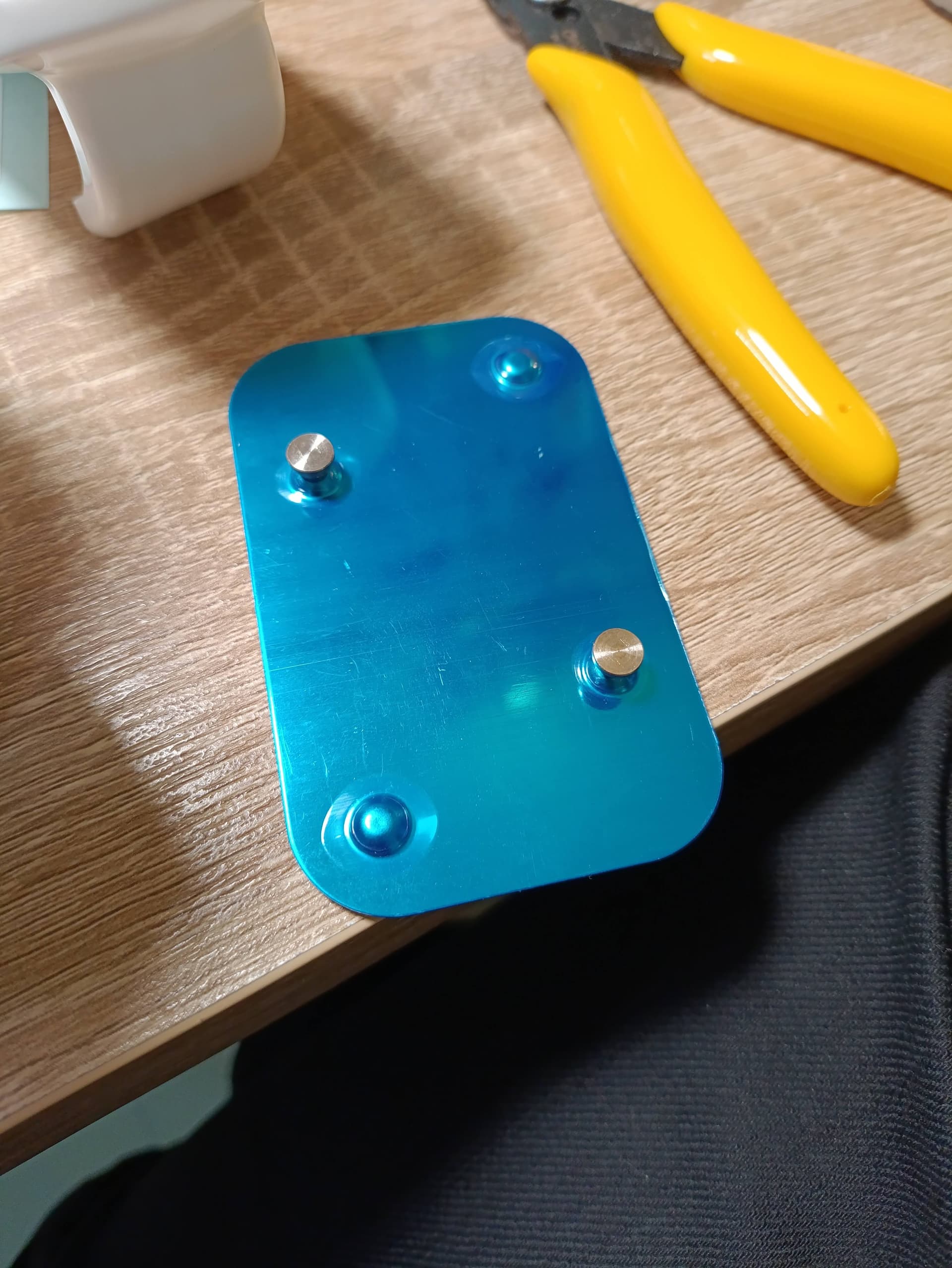

At first, I was thinking about using a plate like this (below), which has screw heads that fit Open Air’s bracket, but it’s still not a perfect fit.

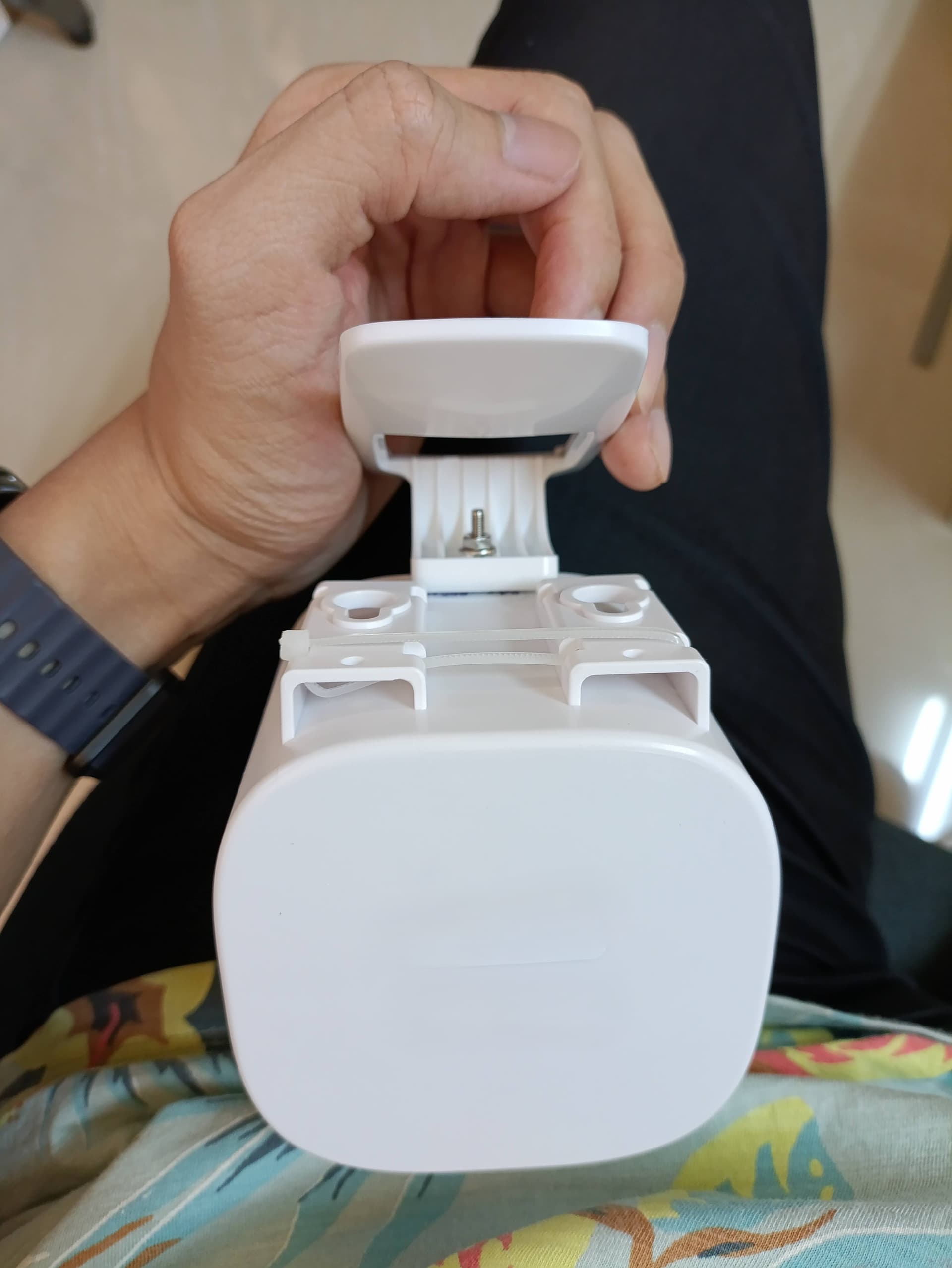

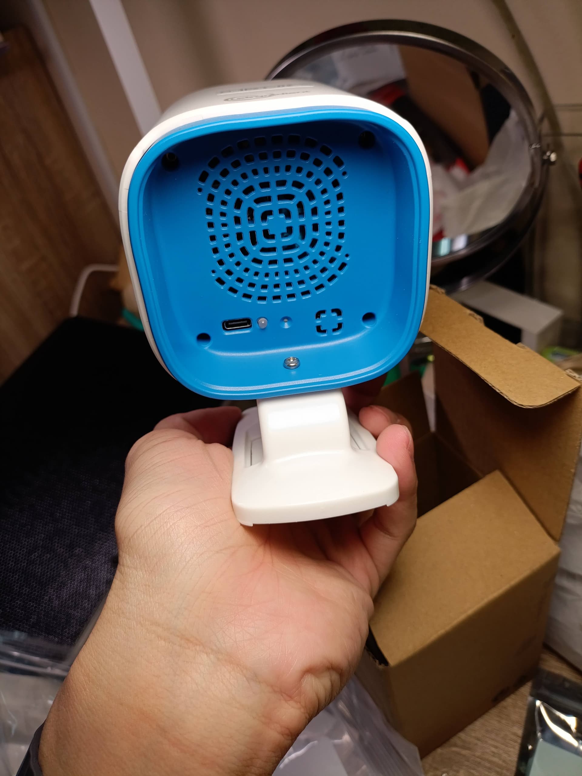

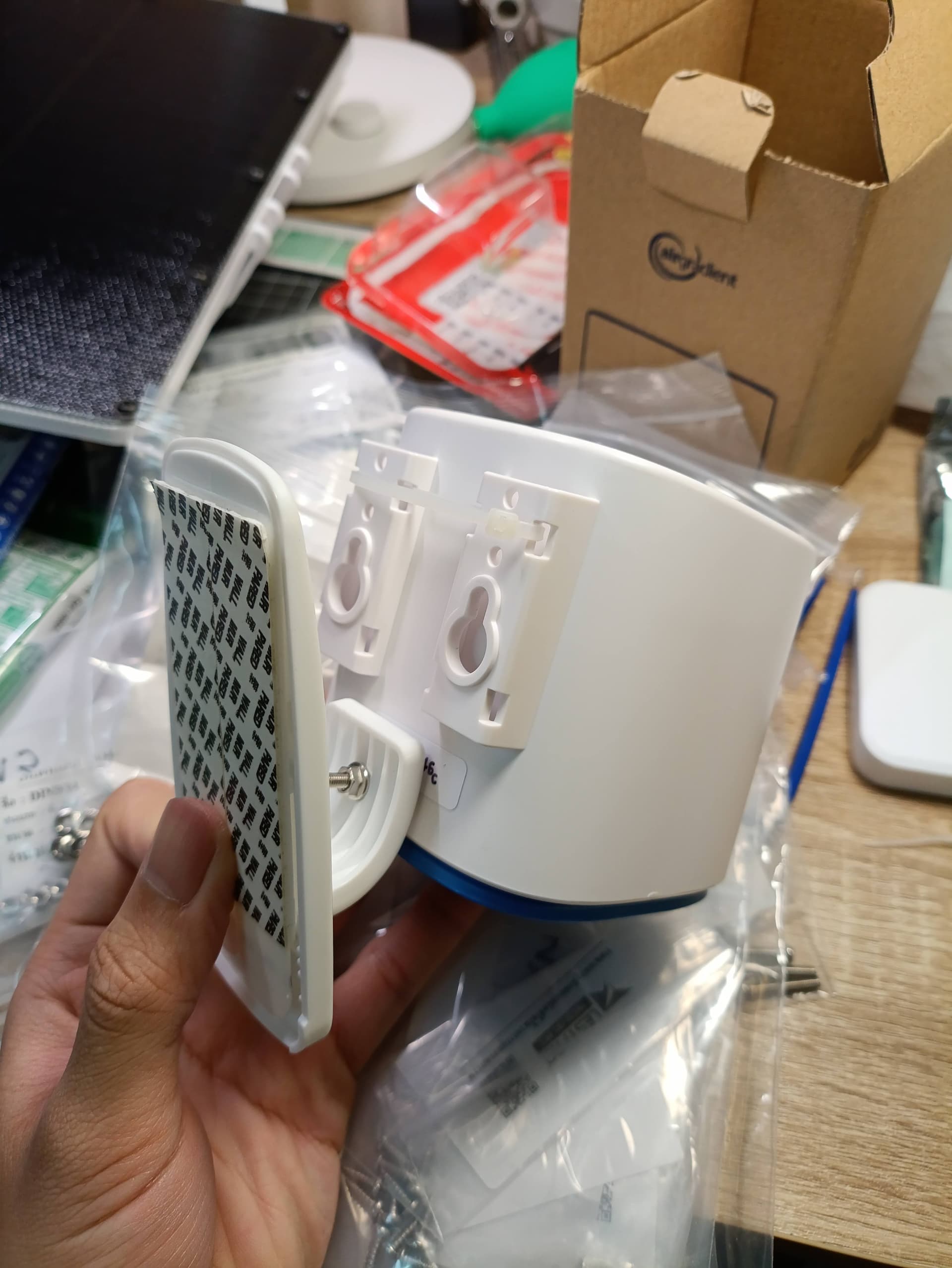

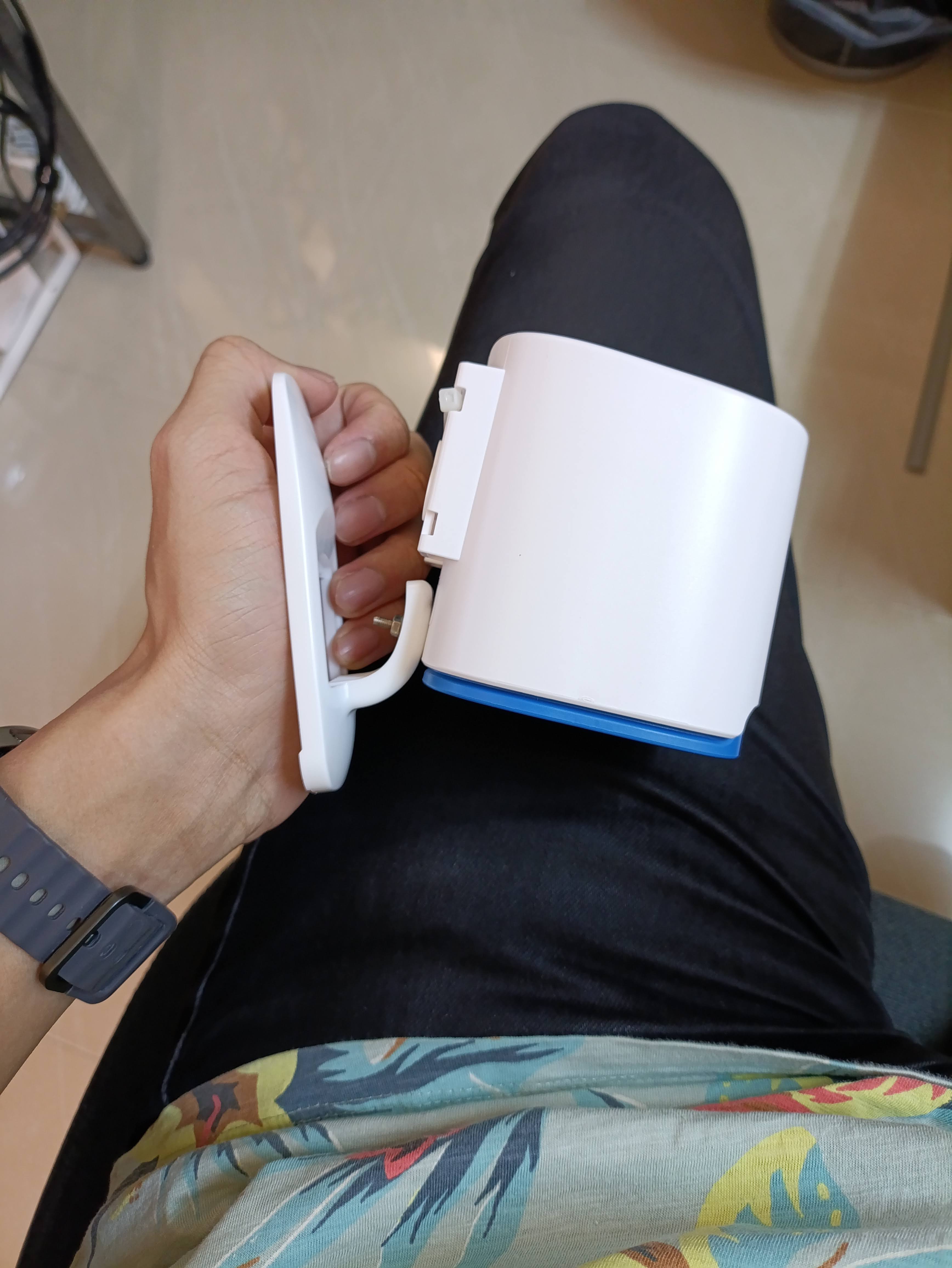

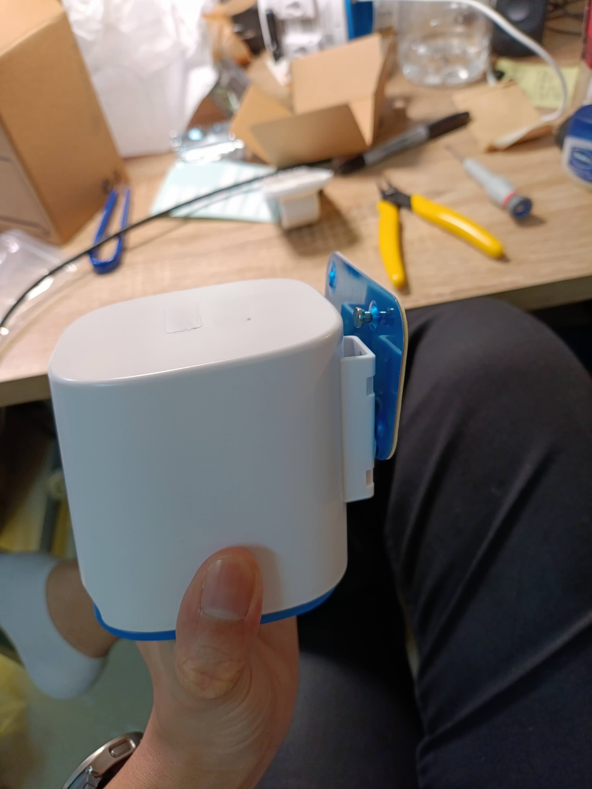

Yes, I just fixed the Open Air to the Command hook with an M3 bolt and nut (through an anti-theft hole of the Open Air).
This 3M Command hook, named Jumbo Utility Hook 17004, which I think is the most cost-effective for my project. It holds up to 3.4kg, so there should be no problem if installed properly.

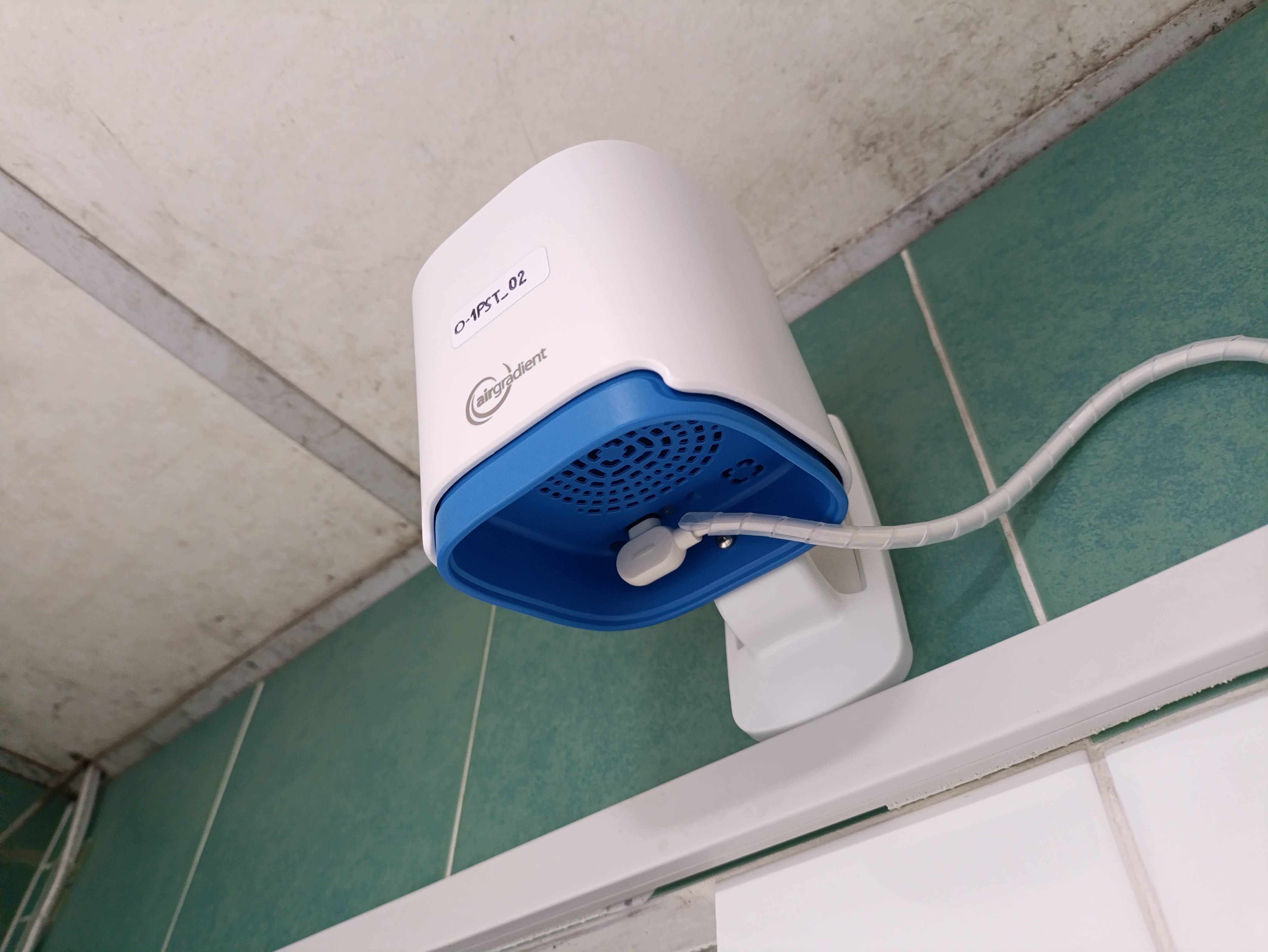

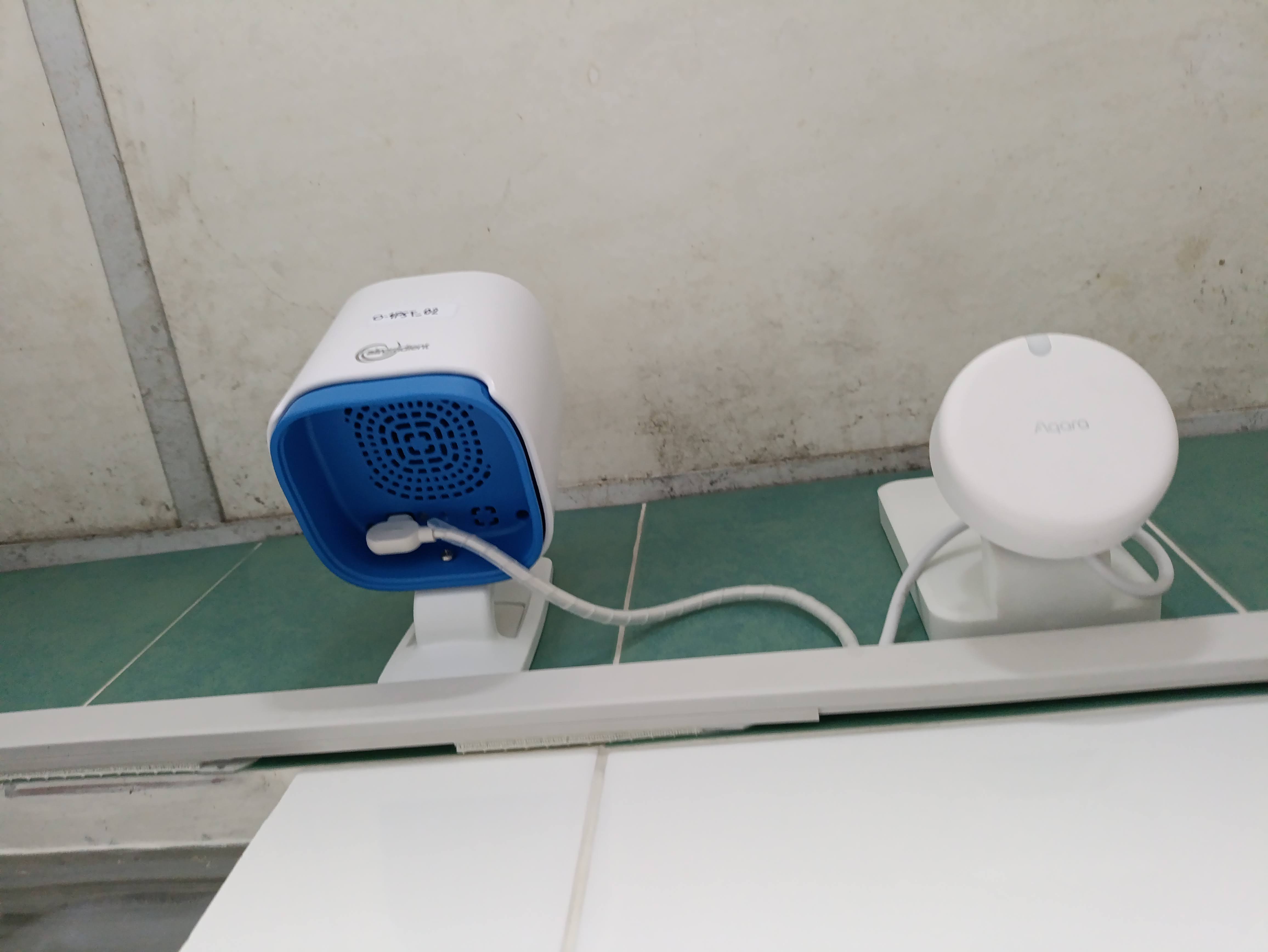

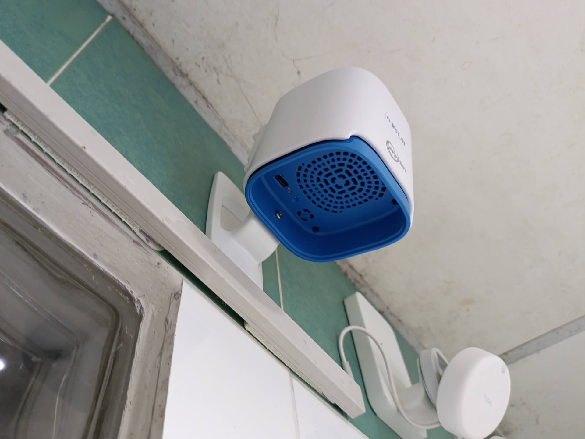

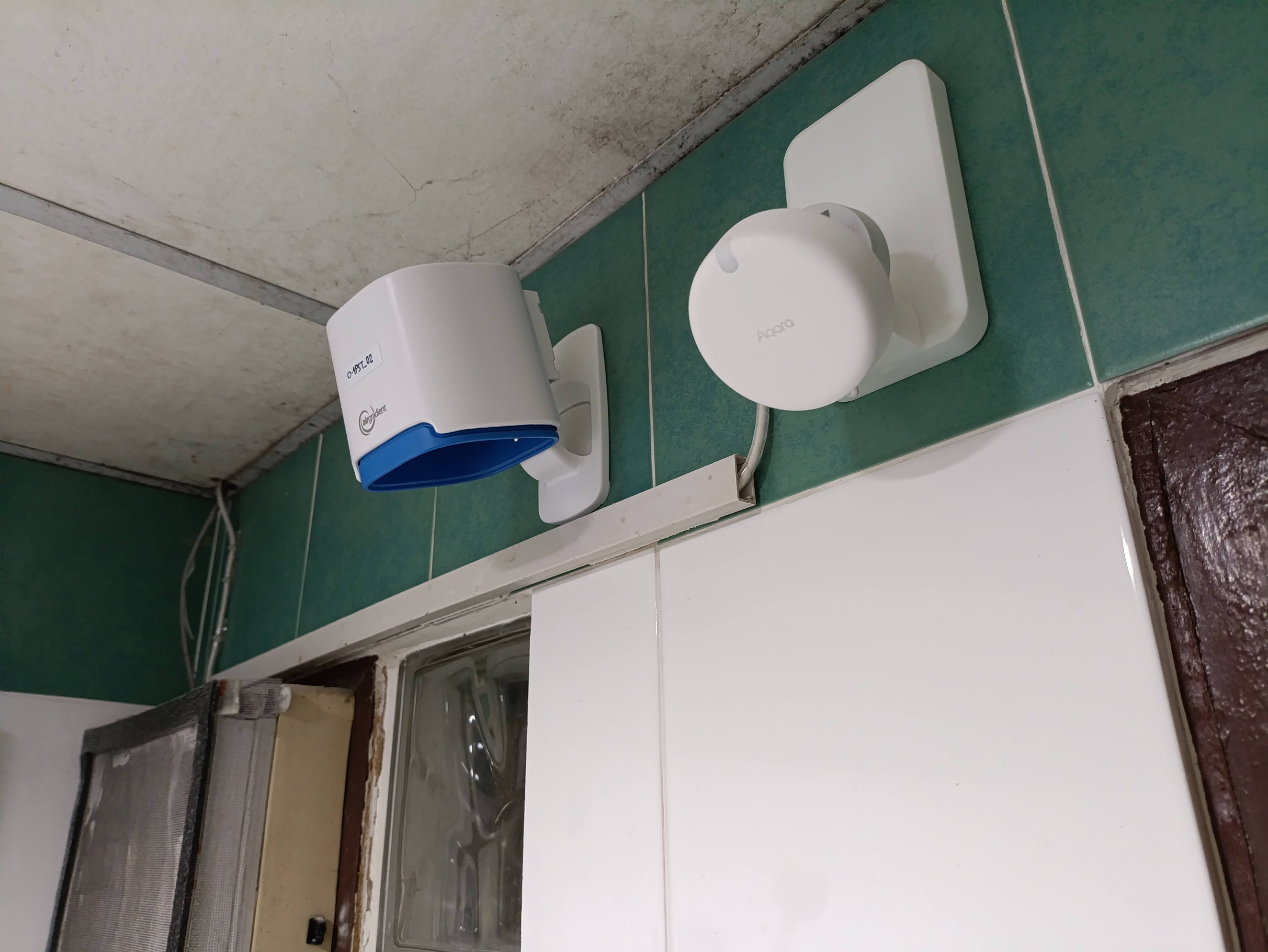

Then deployed it in my bathroom. Sorry that the place looks a bit ugly and old.
Once it was in place, I powered it up with USB-C cable and everything has been running well so far.
Not bad when mounting alongside the Aqara FP2, right?
