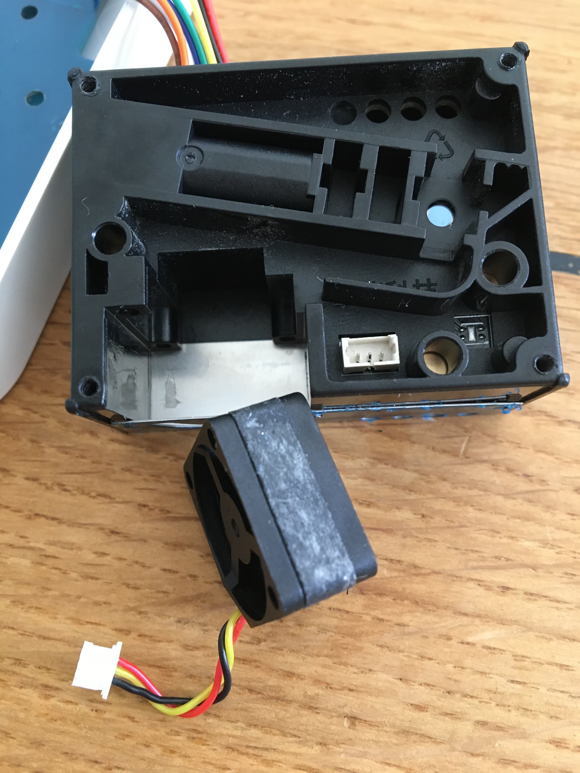

After a few months of use, the PM2.5 sensor fan was becoming louder. Much so, that I moved the unit further from the bed and finally unplugged it. Today I had some time to research this issue and disassembled the AirGradiant One, unscrewed the PM2.5 Sensor and (following a YT video) pried open the sensor to get the fan out.
First thing: super impressive that it was so easy to disassemble :slight_smile: You basically only need TR6 torx and a metal prying tool (I used my ifixit kit).
The fan itself was covered in dust, but nothing was blocking it and it was way less dust built up than I usually see in my laptops. I lubricated the fan using silicon oil and just by blowing you can hear the difference it made. I will assemble everything now and hope that it will stay silent for a while now.

I ordered a few other fans to replace the one I thought was the issue. However, upon testing and recording it while disassembled, I noticed that the fan itself is not actually the issue (the Plantower fan is quieter than the replacements I got). The source of the noise is the fan vibrating against the casing. This can easily be fixed by adding a thin layer of something to avoid the fan case hitting the sensor case.
The old fan does have some kind of double-sided tape on it, but it’s not very sticky anymore, which might explain why this only appeared after a few months.
This is definitely a production issue with these sensors. They should add something better than just a small piece of tape.

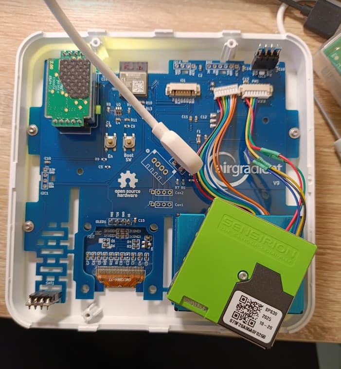

Also, I have some news that we are testing the compatibility of the AirGradient ONE with a different PM sensor (Sensirion SPS30). This could be an alternative.
If and when this becomes available I’d happily install it in one or more of my units to test it out. If it’s quieter (and performs of course) I’d happily pay more for it.
I will definitely post here to let you know when the firmware is out!
I tried to get my ear close to it, and I would say it still has some noise (as it is completely inevitable because it has a fan). I can’t confidently say it is quieter or not (my ears were very good and responsive, but they are not now as time goes by). But I think maybe we can test with a sound level meter!
