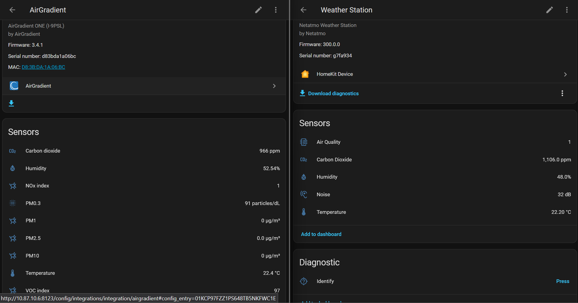

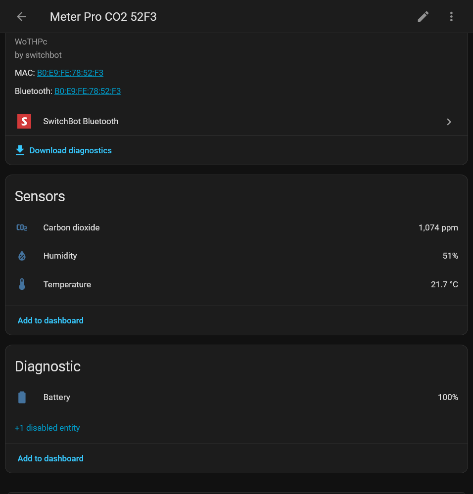

I received my Airgradient today. I don’t want to promote other companies here, but wondered why there are almost no comparisons to be found for Netatmos Indoor unit when comparing devices. So I thought I just provide the data!
Switchbot and Airgradient have been placed outside for several minutes and then CO2 calibration was triggered manually. The devices then have been sitting next to each other for ~45-60min indoors. The Netatmo was just kept where it has been for the last couple of weeks.
For the background story: I have been using Netatmo for a couple of years. But:
  1. I was not sure if it the measurements are accurate
  2. I didn’t like that it is using the could for HomeAssistant
  3. I didn’t like that there is no USB-Power option for the other room sensors
  4. The lack of a visual indicator of CO2 bothered me a bit.
That’s why I came up with the idea of Switchbot sensors for homeoffice/-gym and bedroom and having the Airgradient in the livingroom (also as a reference of calibrating the Switchbots if necessary). Seems like the devices are pretty close to start with, nice :slight_smile:

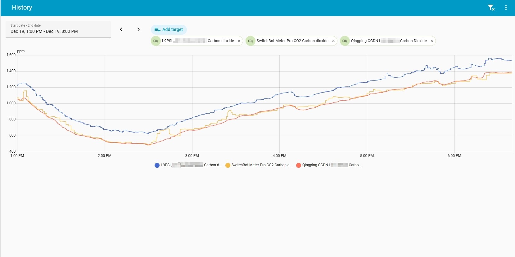

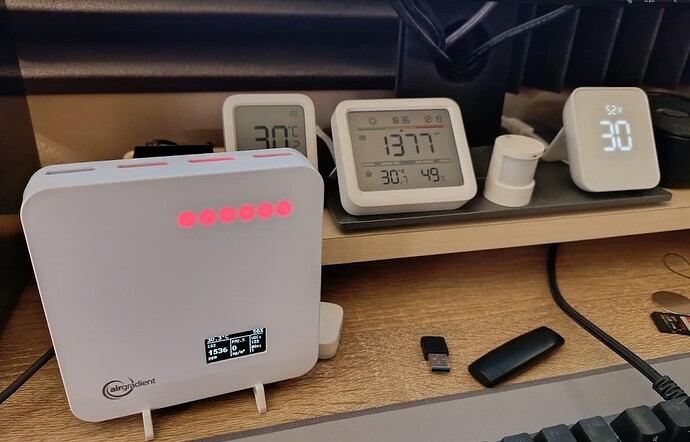

This is mine:
My AirGradient ONE (I-9PSL) and the SwitchBot Meter Pro CO2 (+ Qingping Air Monitor Lite) usually follow the same trend as you see in the chart above.
Note: I have never manually calibrated my SwitchBot and Qingping.
