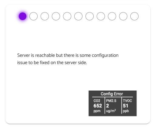

Recently acquired a Gen 9 from the store and very impressed with the hardware and capabilities. Every few days my monitor “locks up” with a purple LED on the far left and two green LEDs on the far right. It is completely non responsive. Removing and re-adding power solves the issues - it starts up, connects to network and is available. I’ve looked through the forum and docs but don’t yet see anything useful in troubleshooting. I also can’t seem to find any sort of logging information that might help with troubleshooting.

Issue seems to have calmed down, maybe a server-side issue? It’s running fine for the last few days. I do recall that one of the times the monitor locked up, it indicated a server communication issue…

What was it doing to appear as unresponsive?
The purple LED is to indicate a server side issue, but it should continue to run and update values
