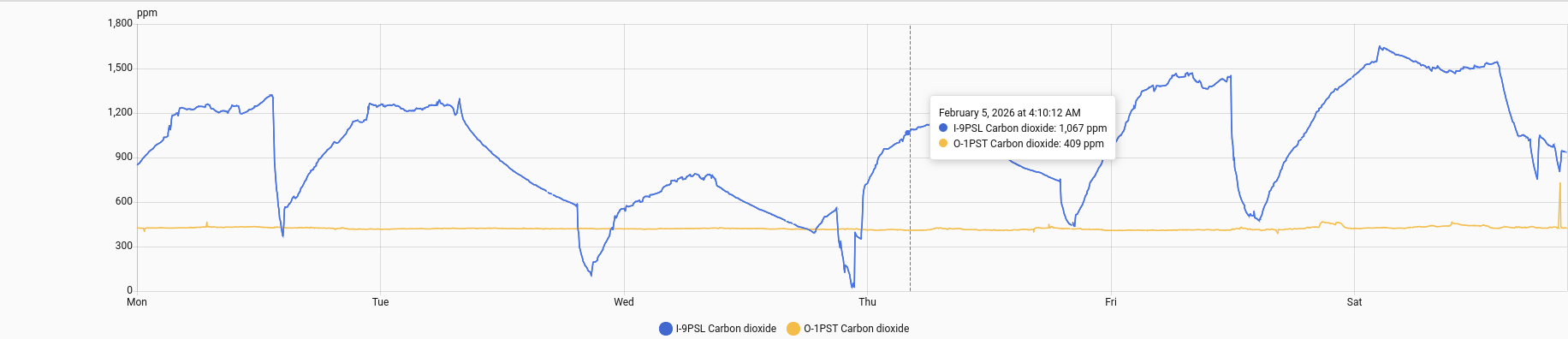

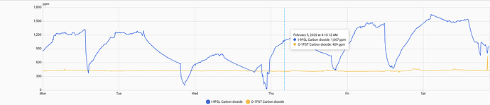

I have an I-9PSL. In the last week I’ve noticed abnormally low CO2 readings when opening the window of the room where the device is.
O-1PST for reference, on a balcony, 5 meters away from the indoor unit.
Lowest value in the last week was 103.

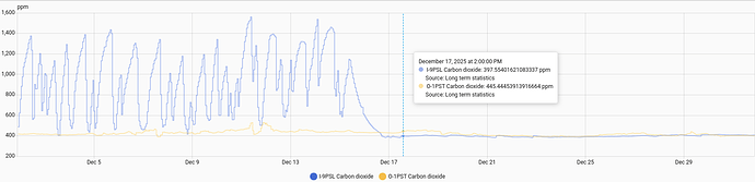

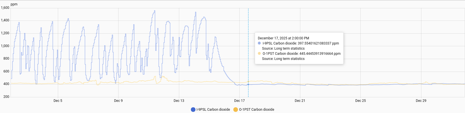

The sensor was working fine until recently. Only thing that might have thrown it off-course was the fact that I left the apartment empty for about a month (from mid-December to mid-January). During this time, the value stayed around 400, but I don’t see how that might have affected it.
Below is the month of December (on the 15th I left):

Any idea what might cause the value to drop so low now?

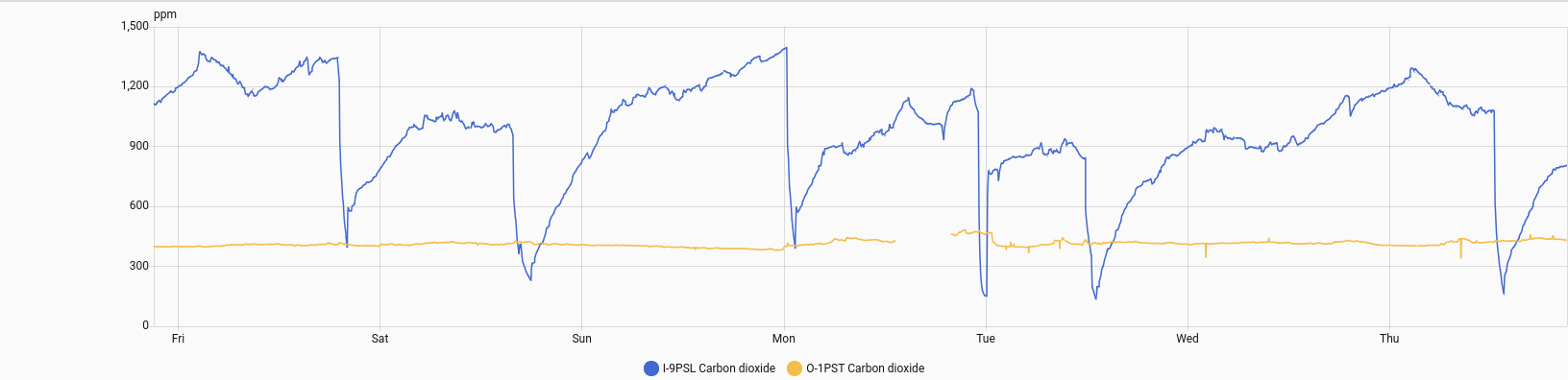

Mine did something like this with values down to 160 ppm and I think it was due to the ABC and insufficient ventilation of the room. I solved the problem with a calibration request leaving the window open long enough.

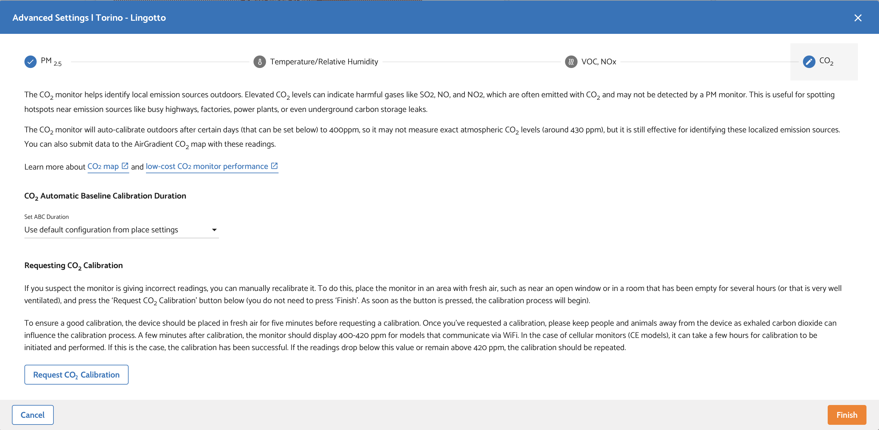

The automatic calibration, indeed is based on the last 8 days (unless you change the settings), so I requested a calibration from the advanced settings, because I thought the CO2 values in my room were too high in the days before that 160 ppm reading.

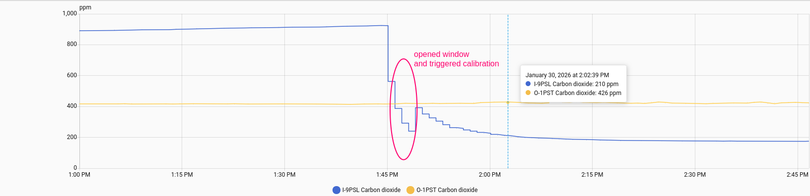

The value briefly climbed to around 400ppm after I triggered the calibration, then starting to slowly decrease. It seems it’s stabilizing around 175ppm.
The device is in a room with the window opened. Door is shut, no source of CO2 in the room.
How quickly after opening the window did you trigger calibration? It needs to be at near ambient levels when you click the Calibrate option, otherwise it is still too high as you see. Now that it has mostly leveled off, I would do the calibration again and it should stay near 400
I’ve found when doing manual calibration that it does take 20 minutes or so to settle after being placed in a minimal CO2 environment. If you trigger the calibration too soon it will continue to decrease as @gis’s graph shows.

I think that was the issue. I did another calibration after waiting for a while and now it seems it’s back to normal:
After Wednesday evening when I triggered the last calibration, the value didn’t drop below 400 anymore. So I’d say the issue is solved. Thanks to all who replied!

On one hand, we’re told that ABC requires the sensor to be exposed to fresh air for about 30 minutes in the last 7 days.
On the other hand, when we trigger the manual calibration in the dashboard, we’re told to first ventilate the room (and keep CO2 out during calibration).
